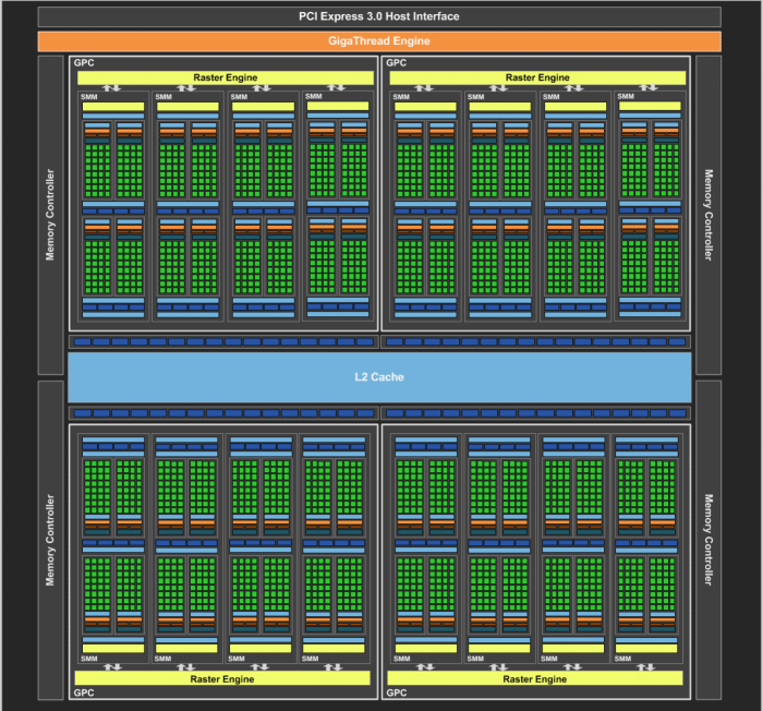

3ziz_3bqr
Jan 24, 2015
Hi all ,
first of all I'm sorry for my bad English
nvidia hasn't told us the technical reasons of the problem
but I have some thoughts about it ( I'm not sure of anything and it's just my view )
the problem isn't how much the Gigabytes does the gtx970 have .. the problem is how the GPCs control the memory controller
how ?
http://www.bjorn3d.com/wp-content/uploads/2014/09/GeForce_GTX_980_Block_Diagram_FINAL-700x652.png
the full GM204 has 4 GPCs each of them has 4 SMMs
and the full chip has 4 memory controllers
so with 4GBs VRAM we can say there is 1024mb per 1 memory controller to control
so there's 1 GPC For 1 memory controller that control 1024mb
and u can say there is 1 SMM for 1/4GB
http://images.anandtech.com/doci/8931/970_Block_Diagram.png
but with GTX970 we only have 13 SMMs *1/4GB = 3328MB !!
and 3328MB is the limit that we get less bandwidth ..
here :
http://i.imgur.com/v7EVufN.png
this is the problem ... the configuration of SMMs and memory controlers that we get with using of more than 3328mb
"Low bandwith"
maybe I'm right and maybe I'm wrong... waiting nvidia official statement
