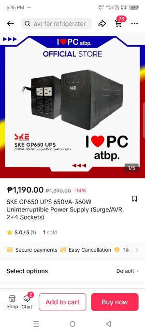

i went to a local hardware store and saw 2 500 watt inverters. one brand was TDE and the other is BOSCA....both are identical to what ive seen in Canadian tire and walmart.. even have a fan in the rear.. that is nice.. but he cost is higher since this is a store...
