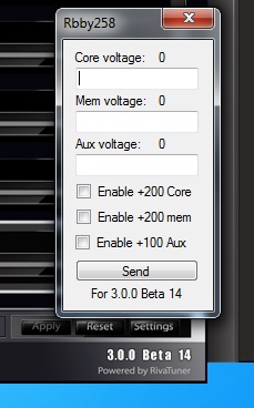

Use the Rbby tool to go higher. That's what I use to get beyond 1.2v on my 780 Lightning. If you want to go higher than +200mv then make sure the box is checked for +200core.
http://www.overclock.net/t/1398725/...s-on-lots-of-cards-some-with-llc-ab-b-19/0_50

290x Lightning - also for over +200 mv
http://www.overclock.net/t/1472341/msi-r9-290x-lightning-thread/40#post_21937945
Well, if you want a higher core voltage, you can try this out:
Quote:
Originally Posted by sugarhell View Post
Guys its easy to give more volts on msi.
Just use /wi4,30,8d,10 for 100mv. The offset is 6.25 mv in hexademical. So on decimal is :16*6.25=100 mv. For 50mv you need 8. For 200mv you need 20( 20=32 on dec. So 32 * 6.25=200mv)
The easy way to do changes:
Create a txt on desktop. Write
CD C:\Program Files (x86)\MSI Afterburner
MSIAfterburner.exe /wi4,30,8d,10
and then save as .bat file. Eveyrtime you start this bat file msi will start with +100mv
For 50mv: 8
For 100mv:10
For 125mv:14
For 150mv:18
For 175mv:1C
For 200mv:20
I wouldn't go over this point because
1)You are close to leave the sweet spot of the ref pcb vrms efficiency
2)These commands add 200mv on top of the 100mv offset through AB gui.That means 300mv
By default /wi command apply to current gpu only. So if you have 2 or more gpus you must use /sg command. That means the command line is something like that
ex:MsiAfterburner.exe /sg0 /wi4,30,8d,10 /sg1 /wi4,30,8d,10
If you want to go higher, here are some more values:
wi4,30,8d,xx
xx being:
30: 300mV
40: 400mV
50: 500mV
Also, Aux/PLL voltage adjusts the amount of voltage going through PCIe, for those who were wondering.

I have been looking for that post. I saw it somewhere in the past and couldn't find it again. I wanted to try this out on my card. Using the tool can be a little annoying, since I like hitting my saved profile and then jumping into a game. I am going to try this out. Thanks Fast for posting this.

I am using the Rbby to go over the official 200mv for a while now.
I tried the other AfterBurner Hack but it doesn't work for me.
Maybe thay patched it in Beta19.
I am on Air so I don't go over 200mv except for Benching, so the tedious use of Rbby tool hasn't bothered me yet.
Yeah the Rbby tool is great for synthetic benches, but for gaming I find it annoying. I wish I could just hit my saved profile and BAM = +200 mv... This is why I just game @ +100mv @ 1306/1656... just being lazy... I guess.
