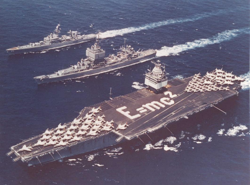

I'm fairly sure the Big E is the only one with 4 separate independent nuclear reactors.
4 independent steam plants, but 2 reactors per steam plant. One of a kind design, the reactors are almost twice the output as the submarine reactors that were being built at that time. Each steam plant can operate with one or both reactors running, although the navy typically tries to go to sea with at least 6 operational reactors, and all 8 are definitely preferred!
Little history lesson: it's said that Admiral Hyman Rickover, to prove that the dual reactor design would work in a surface ship, had the USS Triton (
SSRN-586) designed with a 2-reactor/2-steam plant propulsion system. Up until then, Congress had been reluctant to take a chance on building a nuclear powered carrier, due to the complexity required for the engineering plant. As he usually did, Rickover proved them wrong, and received funding to build the Big E.
Also, the original concept was (allegedly) to build the JFK and the America as nuclear powered vessels too, but due to the enormous expenditure on the Big E, they were instead built as conventional powered vessels. The JFK, CV-66, was the last conventionally powered carrier built for the navy.
It would be very expensive to have Enterprise as a museum carrier. I suspect she will be mothballed and then have her reactors removed. She will then be probably sunk during exercises so the Navy can gather information on how the design holds up to battle damage and how effective the anti-ship weapons area.
Actually, I foresee removal of the entire primary coolant system, including the steam generators, as well as the auxiliary systems that were in contact with reactor coolant at any time. For sure, it will be a VERY lengthy job!! However, all that can be removed without cutting the ship apart, and it's entirely possible that she could become a museum, though they'd have to probably pour a bunch of concrete into the bottom of the ship, to make up for all the weight lost.
So far as using her as a target ship, that really wouldn't glean much information. Along with her reactor plants, her hull design was pretty original too. Enterprise has 3 armored decks (flight deck, main [hangar] deck, and 2nd deck), whereas I believe the Nimitz class carriers only have 2. It's entirely possible that the torpedo trap voids in the side of the hull are different as well. Plus, I'm sure the navy is going to be VERY careful in where the hull ends up, as the environmental nuts out there would have a field day with the navy "polluting the ocean with nuclear waste".
