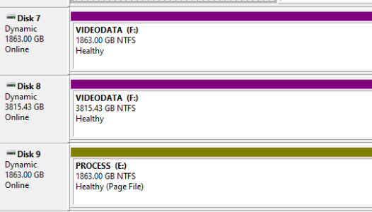

yes exactly, only reading from USB. It is software RAID in Windows (Dynamic Drive) and consists of 5 M2 and SATA SSD drives. No spinning drives.
Copying to the same drive from another SSD over network or on same PC doesn't slow it down so bad.
400/s would be more than enough for me, even though it should be faster in theory. I just not understand why it is slows so badly when In theory i made everything right designing the workstation.
Looks more like JBOD since the drive sizes don't match.
So, the "raid" slows down the copy process.... what happens if you do it to a single disk instead?
