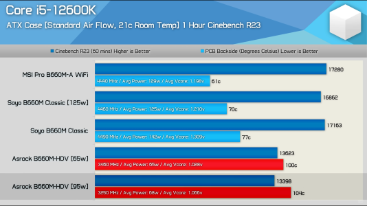

I had that board for a brief time, it's hot garbage; literally.
Even a 14500 is going to be wasted money because it'll never reach full performance as those VRMs will cook first. I'd look for around a used 12400 for dirt cheap if you can use the extra threads. I'd definitely ditch that 1050ti though. It's probably why the game is eating so much ram; because it has to swap in and out of the 4GB frame buffer so often.

From the first about five minutes of that video, the guy strikes me as dumb. His nitpick is throwing premium performance CPUs on a low end board and then it not performing like it would on a Z performance board. This kind of kills his very valid point of non-quality parts on the board.
No it doesn't. There should not be a board that can't run an i5 K at stock properly, period. The performance and thermals in a normal usage scenario/typical case and fan setup are horrendous.

Since you play CPU demanding games I wouldn't go past the lowest i5 XX400 of any supported generation unless you don't mind leaving a lot of performance on the table along with extra money. Because it is just going to underperform to the point that the 12100 could potentially perform almost as well. A used 12400/f is as much as I'd spend on for that board personally. But again, you money spend it how you want. You lost me at thinking Steve Walton is dumb without even watching the whole video. Then if you still think he is dumb, well, that's on you.
Even a 13400F is likely going to throttle in that board at least somewhat. It's effectively a 12600kf with a 65W limit, but even capped at 65W the PCB under the VRMs was hitting 100°C under sustained load with a i5-12600k.
If your bottleneck really is CPU and core count, you might be best selling or repurposing the 12100F with the existing board, and just replacing it with a new CPU/MB combo.
This is why I suggested that you buy a 12400F/MSI PRO B660M-A (or 5600/b550) and pair them with an RX 6600 when you were planning this build. I made you fully aware of the VRM limitations of most of the motherboards in this price tier before you bought your board. I suggested spending extra $15 (at the time) on the MSI Pro B660M-A because of it's improved power delivery and so you'd have a better CPU upgrade path.
