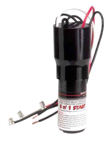

Super sent a technician to fix my fridge finally and he replaced whatever was broken with this: http://www.amazon.com/Supco-RCO410-Start-Kit/dp/B008YDSH6E
Don't know what it is, but my fridge is perfect now. Seems a bit quieter for some reason also, and not clicking on and off as much as it used to. Actually, not clicking at all..?

You could try replacing the relay, and/or the start capacitor. I think those parts are relatively cheap. If that doesn't fix it, then I'd scrap it. Unless it's a $1500 side-by-side that's relatively new, I doubt it's worth the cost of a repairman; since you can pick up a used fridge in good working condition for $100-$200 on Craigslist these days. (See if you have a used reconditioned appliances store in your area.)
