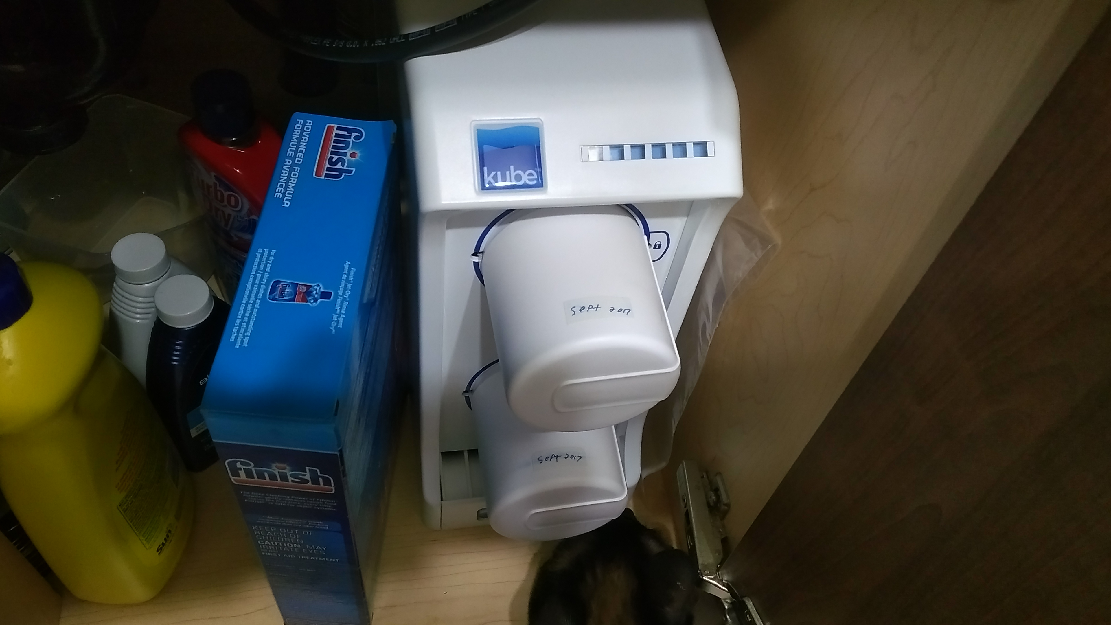

Finally decided to buy a system, went to HD to see what they had in store, ended up getting this one:
https://www.homedepot.ca/en/home/p.advanced-water-filtration-system.1001016342.html
Installed:
This one is a bit different, instead of having a dedicated faucet for the fresh water, it just comes out the cold water tap. Basically you just connect it to the cold side of the faucet. Come to think of it that actually makes sense anyway as in the kitchen I'm probably always going to want filtered water anyway. Whether it's for making coffee or cooking etc. It also has a bypass button so if I need to let the water run for a long time for some reason I can just flip it.
Think this will make me drink water more often too. My old source of good water was to use a Britta to filter it then fill a jug and that was kinda a pain. I found if I put the Britta directly in the fridge the water starts to pickup tastes from the fridge. (pizza especially lol)
So yeah glad I finally bit the bullet. It was ridiculously easy to install too, all push and screw fittings.
Installed:

It's still good so far, only like 1 bar of usage though I think after a year I still have to change it whether it's used up or not, but I'll just wait to see. I'll notice if the water starts to taste funny I guess.

So 3 years later I finally had to change the filter. The indicator was showing red, and it seemed to coincide pretty well with a noticeable drop in pressure. Instructions say to change it every year no matter what, but I figured as long as I feel the water tastes fine I would keep it going.
Home Depot does not sell this system anymore and that was my original fear, of buying into a system that years down the line I can't get filters for, but I was able to find them on Amazon.
I'm hoping I can find a way to recycle these though, there's lot of plastic I hate to just throw it in the trash. I guess it's still better than people who buy bottled water as their main source of drinking water. 😱

Can't even compare the two. Not like I risk blowing something by not changing the filter. They probably just say that as in a typical home the quality would probably degrade faster but with just me it does not get enough use. It's at a constant ~100 PSI I don't think I really need to worry about any kind of pathogens either.
