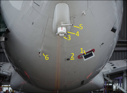

Outflow Valve is #1 in this image:
Fresh water I could see it, but not the salt. They mill the wing lower skins and spars to eliminate those lap joints that are so prone to corrosion, in a plant that I helped build and drive by every day in Fredrickson. That does not mean there are not other laps down low and the salt in there will be devastating, let alone the harness and connectors, etc.
Yeah, you still have the fuselage laps. But there are plenty of other faying surfaces that are getting packed full of salt water right now. All the trunnions and landing gear support beams, pressure bulkheads, etc. If this was a B-2 or something insanely expensive and irreplaceable they might try to make something work, a P-8 isn't that expensive and is still in production. If they do return it to service, I'd love to see the it's first PDM (4C Check) after it returns.
