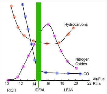

I don't think the metal actually oxidizes, but I could be wrong. In any case, combustion temps increase significantly (and dangerously) as AFR goes toward stoichiometric.
Like this:
But temperature is not exactly what's dangerous, it's the amount of heat that's dangerous. Idling or even moderate loads burning at stoich are fine. While the combustion is hot, there is not a lot of heat or thermal energy. However, if you tried to burn stoich at maximum power there would be too much thermal energy for the engine to dissipate and bad things would happen, like melting pistons.
