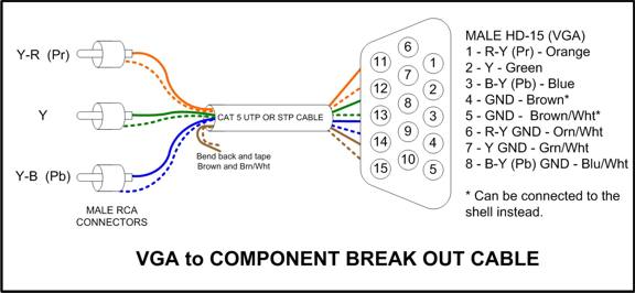

What is the recommended way to go about this? I have, so far, tried using This Cable to connect the VGA to the TV. I have tried both s-video and RCA. Both individually and together, but all I get is a really distorted awful picture on the TV. I am able to get sound working peachy, but nothing in regards to video.

That cable is made for a specific video card. VGA does not output composite or s-video. If all you have is vga out on the laptop and the tv has no other connectors but composite or s-video then you will need a converter.
The boxes sell retail from $30 to $200 depending on the features. For what you want a cheap $30 box will work.

You cannot just connect the component colors to the vga colors and get a picture. The two signals are not the same. RGB on the computer is Red , Green, Blue color information only, there is no horizontal or vertical sync in the color information.
You can combine the sync pulses back into the green using a circuit that results in what use to be known as sync on green connections. Sony made a lot of monitors that use that. It is still not a component signal. Component expects only the luminance on green, it isn't the color green. Blue is sent as blue-luminance and red is red-luminance. The color green is never sent.
