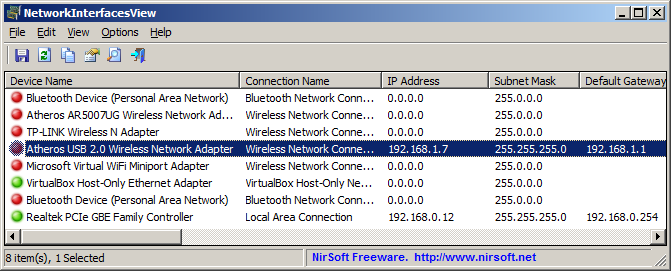

P.S. When it comes to Networking trouble shooting Win 10 is basically useless, most of its diagnosis converting to words what we already know not really offers solutions.
Try these two Portable free Apps, they might provide some additional info.

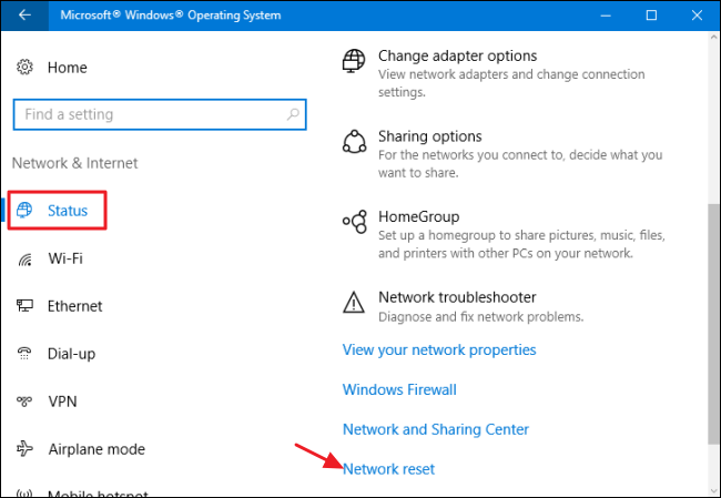

See if Network Reset helps.

Just tried Network Reset, didn't change anything.
