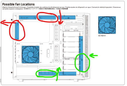

How many case fans do you have installed? Maybe they don't have an optimal arrangement. I see the R5 has the possibility for front hard drive cages that could impede fresh air intake from the front, and the front panel isn't much better, being mostly solid with tiny vents on the side to provide that fresh airflow. Thus, the air going predominantly into your cooler would be the warmed, GPU exhaust air.
I would consider having fans in the two red spots, and then maybe a fan at one of the green spots. The red fans will give fresh air to your CPU cooler and help exhaust it out of the case.
I have two in the front, and the one rear exhaust fan. The front two are fractal designs fans the rear is a Noctua.
I updated my Bios from F4a to the latest beta. I thought I had taken out all the hard drive rails I wasn't using, but I missed a couple. Now the front hard drive racks are all clear minus the two SSD's in there. I'm now sitting at a 47 degree idle. After reading a bunch of posts on this ryzen chip. This seems pretty normal. I'm going to roll with it for now.
