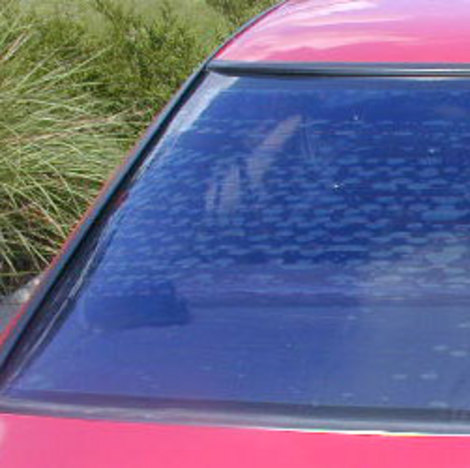

Incoming purple with bubbles windows!
ROFL. See .....that's what I don't want!
