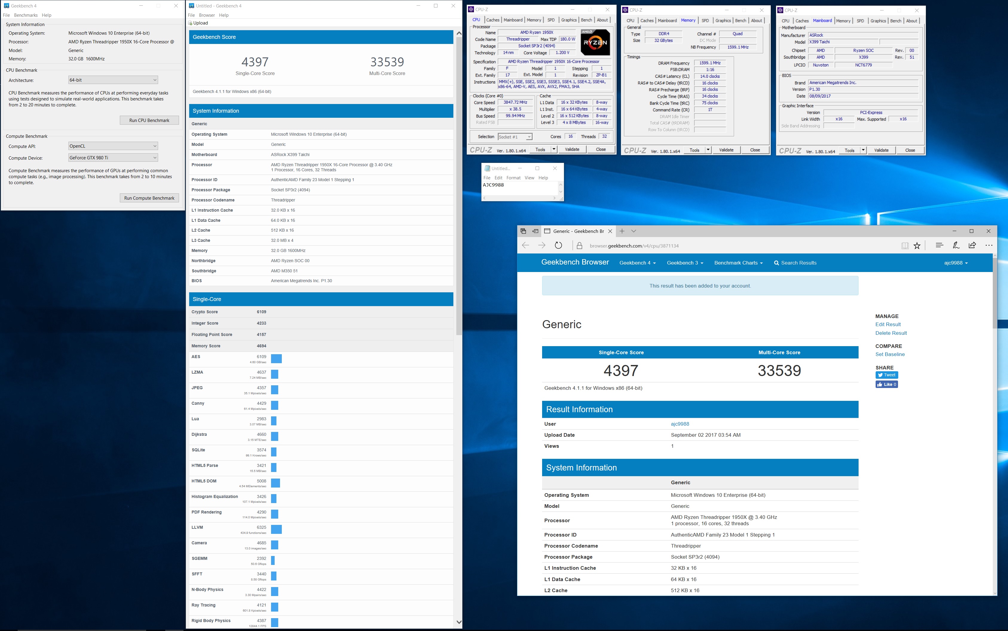

I was planning on doing this myself. Specifically, after getting VRM waterblocks, I was going to either find pre-made ones or buy a copper sheet, drill holes where appropriate so I can use thermal pads with the backside components to the VRM, make sure for clearance, use electrical tape (I have both tape and liquid to spread in a sheet; meant to prevent electrical shorts by contacting traces and solder points on the back), but was considering just leaving a larger part of the plate to sink the back of the socket. My mount for the Core X9 cube has where the drive part is lower, allowing a wind sweep under. So I can attach heatsinks to the plate in the area of that recess and use the fans in the side of my case to blow air in to cool it in part, or so my thoughts go. But, since I'm at my desktop, screenshot time!
I've scored better on some of these since then, but...

@ajc9988 that 32M wPrime run seems longer than I would have expected. Since it runs really short on these processors did you try running with high performance? ie get that multi up to max before the start rather than stepping the multi up through the bench.

I know. I have a lot more work to do on that score (I take it this is the same person I know from NBR and 0_o from HWBot). This is more me just messing around at the moment. I have A LOT more to do after I buy the custom loop later this month after I finish this project in about a week and a half. I didn't even start up in diagnostic mode for this, although I did set high performance in priority, IIRC. That is one of the scores that has been bugging me though, although the 1024m is looking nice. I also just moved to the fall creator's edition beta, which evidently just hates wPrime (lower scores on both). Also, realbench pops up saying that the build has the RTC bug, so I cannot submit the newer scores since I updated to that, as anything without HPET enabled would then violate the rules (I don't get the warning on the Spring Creator's edition, though, so they likely resolved it on that build). That's also why I didn't post the CB11.5 where it had 27.2, I believe. If that was caused by the RTC bug, no use in sharing. I got 22.2 on it on the Spring Creator's edition, though. But more will be coming once I have time to play!;):D
