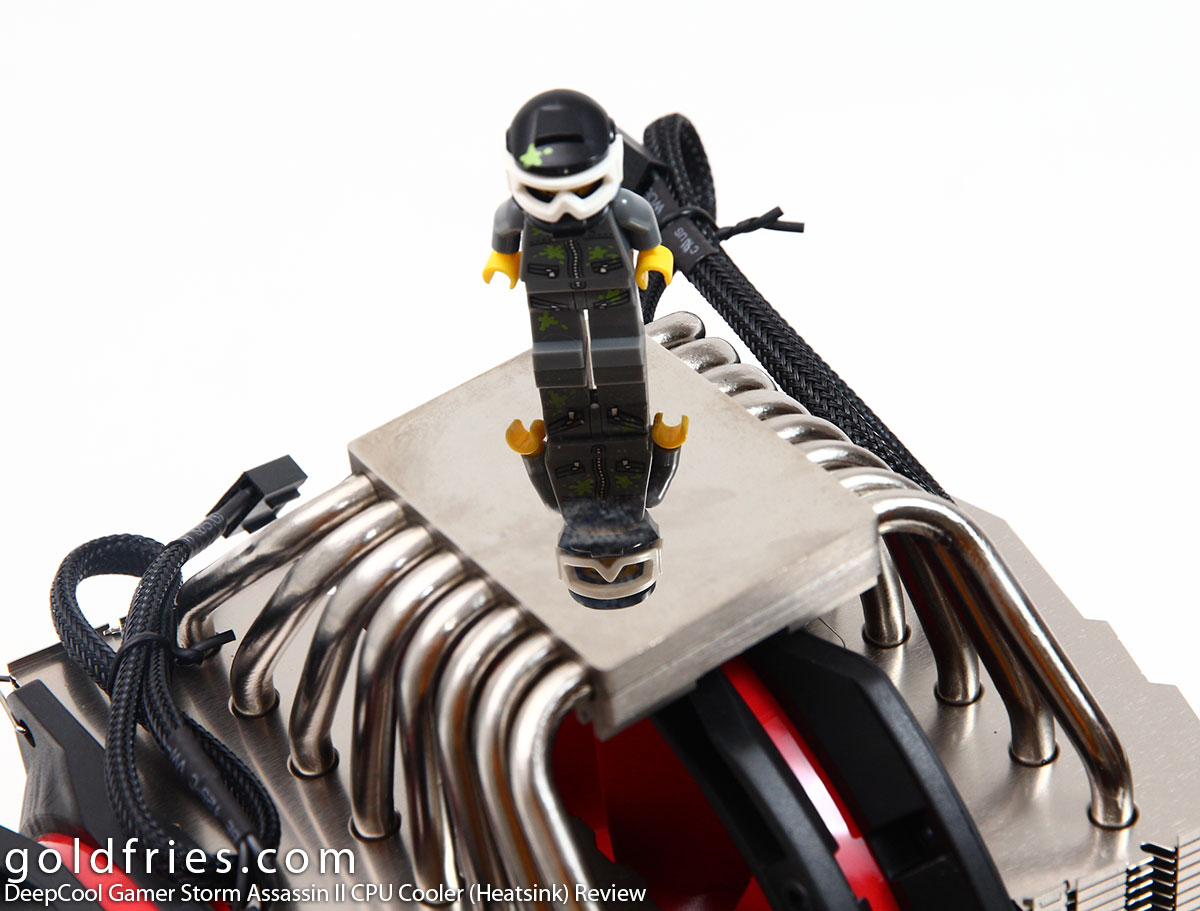

Had to design and 3D print a custom mounting bracket for TR, because there simply isn't any coolers (besides the Asetek ones) available.
Some of the cooler manufacturers I sent inquiries to hadn't even heard about AMD SP3 socket.
The bracket is for DeepCool Assassin II, which is probably the best air cooler for TR despite it wasn't even designed for it. Thanks to it's 60x45mm contact surface, it provides 100% coverage of the cores themselves and 78% coverage of the heatspreader.
Dat coverage !!!
Stilt... you madman !! Doing the proper engineering companies should have done !
Took a look at the cooler you reference.. Zero gaps on the heatpipes exiting off the contact plate :
So, the whole contact plate has transfer heat capability. This is very much unlike the Noctua that seem to have expanded the contact plate and done nothing to ensure the heatpipes contacted the expanded surface. The sheer number of pipes on that thing !!! :anguished:

Dat coverage !!!
