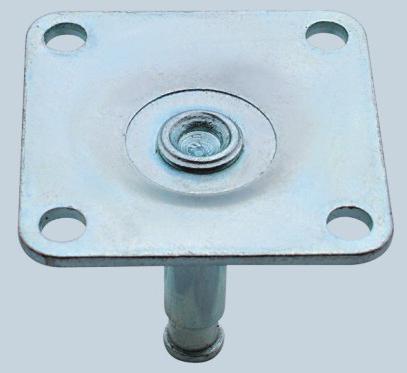

I would make a metal plate the same size as the one on the legs with mounting holes drilled out and nuts welded to it. Drill out space in the wood for the nuts so the plate sits flush. Screw the plate to the bottom of the wood with flush mounting wood screws and you are all set. The metal plate re-enforces the leg connection and ensures a flat mount and every time you insert or remove bolts it will always be a metal to metal connection. Very stable but requires use of a welder, can probably get an auto shop to do it cheap if you get the metal all ready to weld.
thanks, that gave me an idea. anyone know where I can get something like this:
http://www.alibaba.com/product-gs/207769649/J_plate_and_bolt.html
in the US? tried searching mcmaster but couldn't find it.
