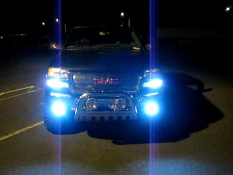

I stopped by my parents house and as I was leaving some guy was behind me with these lights for a small portion of my drive back home. During the whole drive I could barely see anything because it felt as if I stared right into the sun for half an hour without stopping.
My eyes STILL hurt and it's been about half an hour. When I close them I can still see the car. Seriously, why are these even street legal? There's no reason to have headlights that bright unless it's on a search helicopter.

The problem with the lights is they are not made to just be thrown into the socket. Professionally installed, you can tell they are they HIDs, but they aren't blinding, because they are installed correctly at the right angle.
Nik
Jun 5, 2006
16,101
56
They require different reflectors. Dumbasses buy the HIDs and put them in with standard reflectors because they're cheapass dipshits.

Several things come into play here...
First of all the laws limit wattage not lumens. HID lamps have much better efficacy than incandescent (tungsten-halogen) lighting. This is why a legal (wattage) 50W HID lamp is much brighter than a 50W (also legal) quartz-halogen capsule.
These lights don't produce an even spectrum like tungsten lamps either. It's VERY spiky and often in the case with Chinese lamps having a very HIGH output in the blue and near UV region. Bulbs over 5000K actually HAMPER visibility rather than help. 4100K lamps provide best illuminating power without giving everything a morbid blue cast.
Finally comes control and cut off. It's extremely important to have the edge of the light pattern cut off abruptly so the light does not impair the vision of oncoming drivers and pedestrians! What a lot of people do is retrofit their existing optics/fixtures with a third party HID kit. While this may physically fit the reflector, the lens is computer designed to produce the best cut off pattern and throw for highway use. Putting a short arc metal halide capsule in there can have near disastrous results with blinding sidespill in all directions. This is a super nuisance to other drivers! Adding the high Kelvin lamps exacerbates the issue more.

HID retrofit in a halogen reflector = BAD. I certainly agree.
I did some number checking and a 35W HID bulb has nearly the same number of lumens as a halogen 65W high beam lamp. Put 50W HID bulbs in there and it is even worse D:
HIDs always need a projector, or a reflector designed for them. When I see someone saying "hey check out my HIDs they're so bright" I'm like "yeah good job blinding other traffic." I usually get strange looks, or this one guy I know will argue until he is red in the face about why HIDs in halogen reflectors are "just fine." :rolleyes:
Also, those really blue lights don't do much for visibility. I'm running 5000k bulbs.
