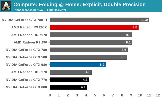

renderstate
Apr 23, 2016
237
I don't think it's the power gating, I think it's simply the fact that Maxwell stripped a lot of the compute resources from Kepler in order to achieve the efficiency it gets in purely graphical workloads.
Example:
If you calculated perf/watt in these types of workloads Maxwell''s efficiency would be abysmal compared to Kepler and GCN.
So all AMD has to do is to remove support for fast double precision math on their gaming oriented GPUs? This is naive at best.
Clearly there is so much more to NVIDIA HW power efficiency that we don't necessarily know about and that we might never know.
Example:
