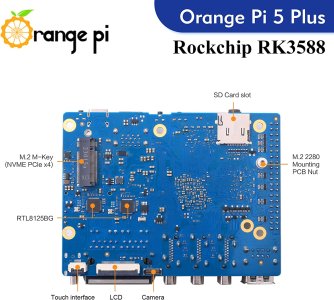

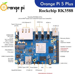

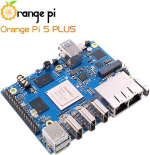

Orange PI just announced what is petty much the best RK3588 SBC period.
#OrangePI5PLUS will be available soon. Rockchip RK3588 SoM, 4/8/16GB RAM, eMMC socket, M.2 socket for NVMe SSD, WIFI+BT, and more.
OPi5 Plus 4GB----89.9USD/piece
OPi5 Plus 8GB----109USD/piece
OPi5 Plus 16GB---129USD/piece
