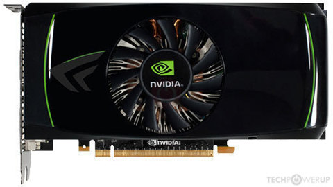

Wow, still rocking a GTX 460. Such a classic. I had acouple of them. Surprised that they play modern games. Maybe won't play DX12-only games.
It is the absolute minimum card listed for Deep Rock. So... I am thinking it would work? I just don't want to have him playing some slide show and taking a long time to load in while the rest of us are playing what might look and feel like a totally different game. That wouldn't bring him back next week 🙂
I think he got his money out of it!
Looks like it might pack as much punch as a Radeon iGPU. Only missing lots of things like DX12 support.
Thems fightin' words! 😛 The Vega11 is the 2400G on that chart. Which said chart isn't going to be at all accurate in 2022 for the 460. 1GB of vram, legacy drivers, and lack of modern features would have it trailing considerably in newer games it can run. Hopefully it doesn't have any rendering issues with DRG.
Fermi did get sort-of DX12 support with the last(?) drivers released for it. It's only Feature level 11_0, so it's not "real" support in that sense. But it will run DX12.
