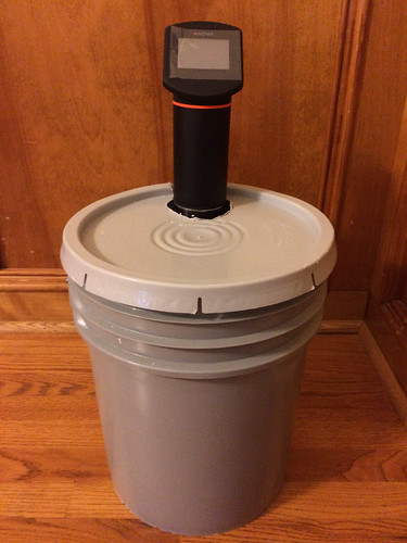

I'm pretty much convinced to get this. But I haven't seen any mention of using 5 gallon paint bucket with this device. Would it not work? Would the plastic melt? I think 5 gallon paint bucket wrapped in insulation foil and lid would make for an excellent container. The paint lid even has a precut hole.
I don't think the bucket would melt. We are talking temps between 100-150 depending on what you are cooking? I've poured boiling water into contractor buckets like this without issue. I might want to use a food safe plastic bucket, but with the food inside plastic bags, I feel there is enough insulation between the food and any chemicals leached from the bucket.
The only negative about using a bucket is the depth of the water. I'm theorizing here but I think a smaller and shallower volume of water would work better. The circulator flows water and perhaps (i'm eyeballing the height of the circulator vs the depth of the bucket) there may be too much water for the circulator to mix properly? Looking at the cooler in the OP vs the larger amount of water and taller shape of a bucket.... maybe someone who owns one can comment?

The cooler I'm using is 7 gallons and it has to be filled close to the top to get the water level mid-way between the min and max fill marks on the Anova. I think the theory is that more water provides for more stable temps.
My concern with using a paint bucket would be stability. Filled with water it should be fairly stable but I'd prefer having a wider base on the container. Also, when placing the Anova through the hole in the lid you'll need to cut out a place for the clamp tang to slide down into. And what would you tighten the clamp against?
I don't know if chemicals leaching from the bucket, if any, would be an issue. Except when doing eggs, the food is sealed in a bag and doesn't actually come in contact with the water.

I figured the clamp could be attached to the side of the bucket like you would do if you're using a large metal pot. It seems like it would work looking at the picture of the device.

My paint bucket setup. I did have to cut the lid.

hmm, looks nice there, ponyo. I'm considering either this or the Sansair, and it now seems like the Annova is getting better-reviewed, plus the current availability....
With these circulators, I was considering using them in a large stockpot. Now, is that ill-advised b/c of temperature transference in stainless steel vs the plastic in a bucket or cooler?

Is the paint bucket food safe? Why not get something like a Cambro box?
The Top Dog around here sells them for about 2 dollars each. Their relish ships in 5 gallon buckets like that--so I'm assuming there are definitely food safe versions.
