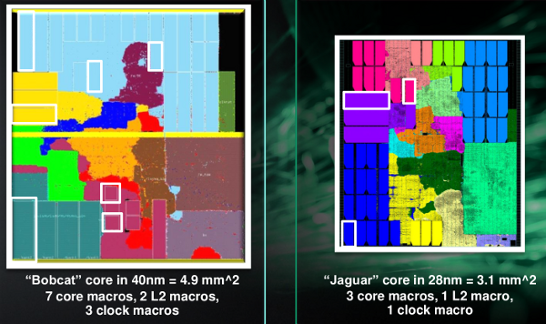

NTMBK
Nov 14, 2011
10,521
6,037
Porting a CPU layout from a foundry process to another one
is not , or rather wasnt , economicaly viable because you ll
had to redesign the complete circuit in function of the new
process transistors caracteristics but if they managed to do
so with Jaguar means that their computerized tools are very
advanced and work well so they ll need far less workforce
for implementing their future designs.
AMD were shouting from the rooftops about how much effort had gone into making Jaguar easily portable.
("Macros" refers to portions of the design which will have to be hand ported, i.e. are not done with automated layout tools.)
http://semiaccurate.com/2012/08/28/amd-let-the-new-cat-out-of-the-bag-with-the-jaguar-core/
They're trying to make it more like an ARM core- easy to port to multiple different fabs. It's part of their push into "semicustom", trying to make it as easy as possible to produce a part that their customer wants.
It also makes sense for consoles, big time- traditionally, console chips will go through multiple die shrinks over their lifetime to reduce overall costs (smaller die, smaller power supply, smaller cooling systems) so a design which is easy to port to new processes is very attractive to MS and Sony.
EDIT: Also, don't forget that they supposedly had a port of Bobcat to GloFo's 28nm process finished and ready to go ("Wichita"), but that product got canned due to GloFo's 28nm delays.
