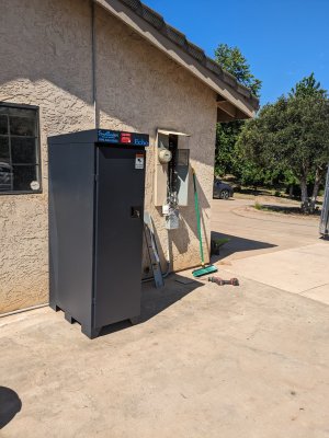

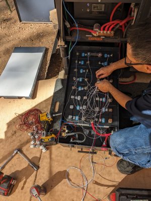

They are LFP Batteries rated for 10,000 cycles to 70% Capacity. I am expecting at least 2-decades of service out of them.
The batteries themselves are in a cabinet and 16 cells (3V by 280 AH) are setup in serial to make a 48v battery. With a total of 5x 48V Battery to give me about 70 kwh of storage. The battery cells are accessible if you open up the battery box. In theory if one of the cells went bad and the installer was no longer available I could replace a bad cell myself. The installer orders the cells in bulk from China and then assembles them in a UL fire rated cabinet for installation. That is one of the reasons I went with this company is the batteries could in theory be serviced by the home-owner themselves. No black box like a Tesla Powerwall or other home storage solutions that a homeowner couldn't fix themselves.

As a safety engineer who keeps having to deal with li-ion battery packs I wonder how they handle thermal runaway for residential packs. A good design will handle catastrophic failure of a cell without allowing propagation to adjacent cells.
The cabinet is UL 9540A rated. (https://www.ul.com/services/ul-9540a-test-method)LFP batteries have more thermal stability than Li-Ion NCA or NCM batteries and this reduces the chance of thermal runaway. Looking at the cabinet design, it appears that if a Cell had thermal runaway that it could propagate between the cells that are connected in serial. However the 16 cells that make-up a 48V are in a metal box that would then prevent propagation to the other batteries in the cabinet.
