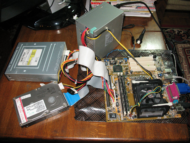

Actually, the anti-static bag (the silvery kind) actually can cause problems with the board. The way these anti-static bags work is that they're coated in a conductive material, so that it forms a faraday cage around your item. If you place something on the outside of it, it may cause it to short (it's happened to me before, we had a board not work while it was on top of a bag, but as soon as we took it off everything worked fine).
The better option is to use pink anti-static bags, in this case they're neutral (won't cause static electricity, but won't stop it either).

As we speak I am breaking in a new computer so I took a quick pic.
I have the case but I never put a computer together before testing the basic components on a table.
The most important thing is to put the Mobo on the static bag that it comes with.
Here you go, http://www.ezlan.net/example/table-test.jpg
During the years I put practically hundred times Mobos on their plastic bags and never had a problem.
