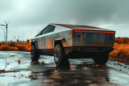

Here's another article about the orange cybertrucks.
SFGATE: California Cybertruck owners find 'orange rust marks' on $80,000 cars.
- For anyone who doesn't read the article, it's not the stainless steel but adjacent metals that bind to the steel during the manufacturing process that are rusting (small flecks of iron shavings that bind to the streel and rust when exposed to moisture).
Easy to remove with an application of Bar Keeper's friend and likely a one/two time phenomena for new truck owners.
Why wasn't that cleaned up before delivery?
That can also cause stress corrosion cracking in stainless steel. You are supposed to protect stainless steel from carbon steel during manufacturing. Then you should passivate it as well.
