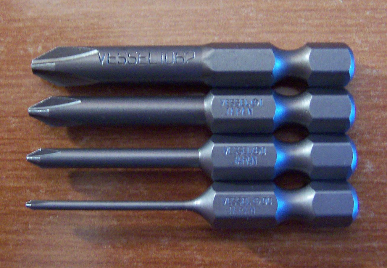

The issue probably is the screwdriver you are using is a Phillips head. Most screws used in electronics are JIT Head Screws.
Very common mistake made by many people. It doesn't help you now, but will in the future.
JIS - Japanese Industrial Standard
Often improperly referred to as Japanese Phillips. Commonly found in Japanese equipment. JIS looks much like a Phillips screw (and even more similar to Frearson), but is designed not to cam out and will, therefore, be damaged by a Phillips screwdriver if it is too tight. Heads are usually identifiable by a single raised dot to one side of the cross slot. JIS B 1012:1985 screw standard is throughout the Asia market and Japanese imports. The driver has a 57 degree point with a flat tip, parallel wings.
Advantages and Disadvantages of JIS
Most people and companies outside of Japan have absolutely no idea what they are. With the similarity in appearance to the Frearson and the Phillips the screws are often damaged in removing and installing with the wrong tools. JIS tends not to camout like Philips. The JIS driver can be used on Phillips quite easily but not reciprically. Drivers are not easily available in North America, try your local RC Airplane hobby shop. Most RC Helicopters use JIS screws to mount the propeller. JIS-spec cross-head screws are generally marked with a single raised dot or an "X". JIS always fit Phillip fasteners, but because of slight design differences, Phillips drivers may not fit JIS fasteners. (unless the tip is ground down a bit).

Pcgeek11 is correct. Most laptop manufacturers use the JIS standard for the tiny screws in laptops. The JIS screwdrivers fit better in JIS screws than Phillips in Phillips. It doesn’t matter which market the laptops are going to. You can usually use Phillips on JIS screws if you are careful and the screws don’t have much thread lock on them and are not too tight.
I found this out when I started repairing laptops. I ordered a comprehensive screwdriver kit from iFixit that handles all small screw types.
I have a set like that myself, just a cheaper knockoff from Amazon. Bought it specifically to start opening laptops 5-6 years ago cause I needed Torx. Used my trusty old little magnetic Phillips to get in, then Torx once I did. Just did my few dells and my sister's old lenovo.
Go ahead and Google it. I tried a lot of variations of searching what you need to open different types of laptops, from in general to various brands. The most common screws on the most popular laptop brands like dell, asus, lenovo, etc... are Phillips and Torx, and Apple uses a Pentalobe security screw type. I'm sure some jil's are out there in western nations these days but it's a small minority, according to the internet, from laptop repair sites, including iFixit and others, to laptop and computer forums.
