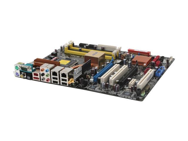

Do you have a digital coax out on your mobo/sound card?
Heck if I know...
Mobo
Rear Panel Ports
PS/2 2
COM 1
USB 4 x USB 2.0
IEEE 1394 1 x IEEE 1394a
eSATA 3Gb/s 1
S/PDIF Out 1x Optical, 1x Coaxial
Audio Ports 6 Ports
Originally posted by: PurdueRy
Yes you do. That would be the yellow RCA connector.
