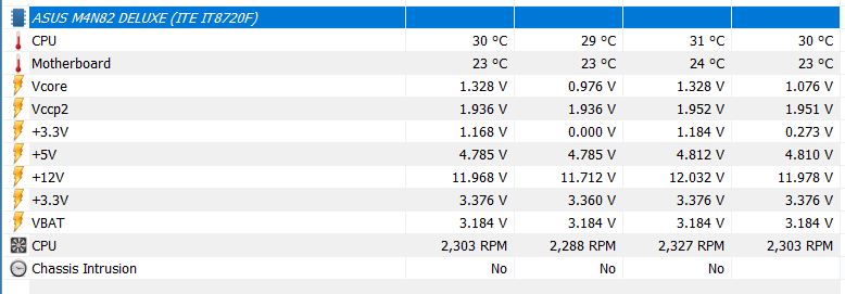

As seen above -
-12V is -1.42V
5V is 1.83V
temp3 is -128C
Yeah. The numbers on the far right are the ones I'm seeing in bios. Not sure why the other ones are so out of whack,
As for the -128C. I had done a google search and apparently there's a bug with speedfan that tries to read a sensor that doesn't exist, and gives a false high or low reading on temp3.
Does anyone know of another program that would show the voltages?

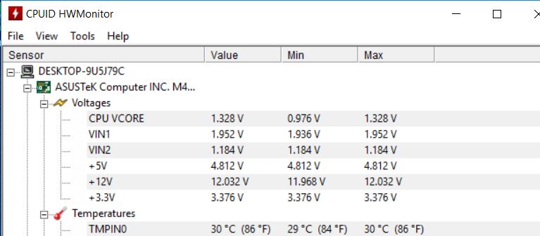

Thanks for the link. I ran both hwinfo64 and hwmonitor. Both are close to what I get in bios. With the +12v, +5v, and +3.3v all within acceptable ranges. hwinfo64 does show two readings for the +3.3v however? And neither have all of the readings shown in speedfan however. Maybe they don't exists, hence why the readings are so out of whack in speedfan?
