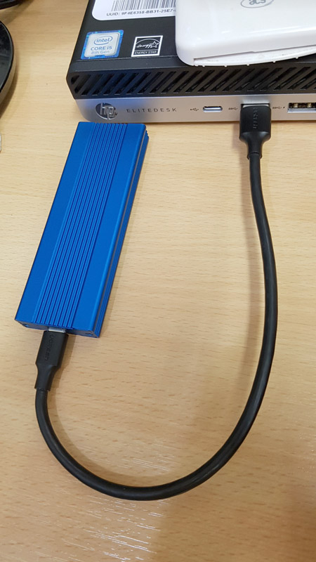

Okay, so far I've also seen that cables differ in quality. I'm willing to use an aapter that plugs in dierctly to an USB port, without cable (into a laptop, or backside USB port of a desktop, that is soldered onto the motherboard, so there is no cable involved, as in front-USB ports).
Like this one: 61O0e2yV23L._AC_SL1000_.jpg
Still, I'm looking for very stable ones that maintain high speed.

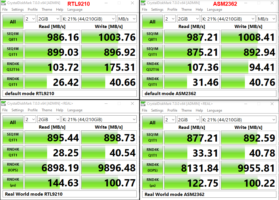

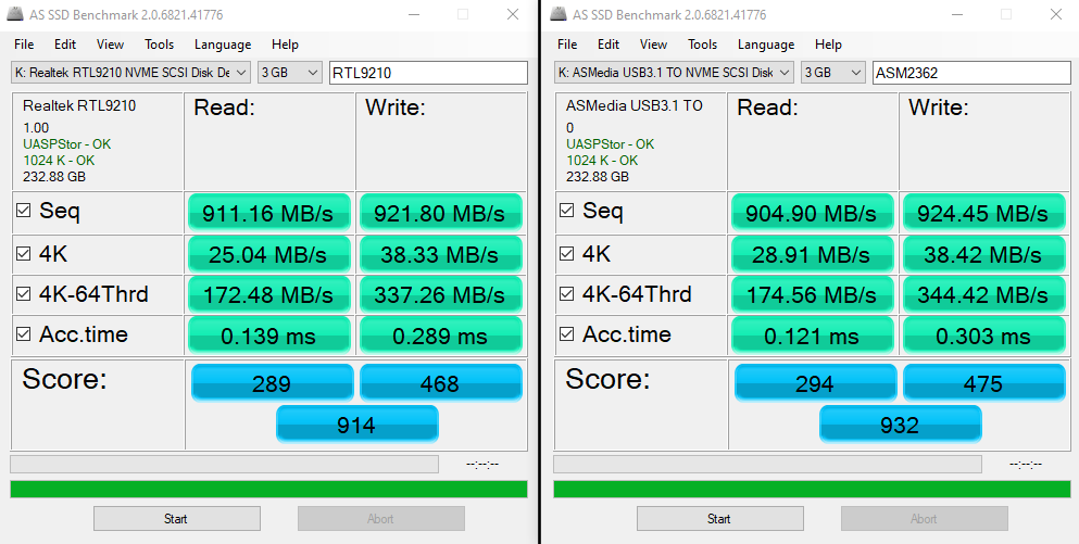

cyberjedi
Apr 4, 2010
23
18
Samboy, thank you very much for your valuable contribution! RTL9210 looks promising!
I only had very limited time to test my sample (see post #8), it is a JMS583, and only with a 5Gb/s USB 3.0 Type-A port. "AS SSD" benchmark resulted in a typical SATA SSD speed, which makes me sad. CrystalDiskMark froze the system while running - this is unacceptable, but hey, at least it didn't crash the system. I had no access to 10Gbit/s USB 3 Type-A port, nor an USB-C, I'm still curious if through those, can a whole ~100GB disk image be cloned successfully and speedily. I will try this in the coming weeks, this is my main purpose and test in mind.

got realtek 2weeks ago but bad luck I accidentally dropped PCB while remove. port type-c soldering cracked I need some mobile phone repair shop help.
but I do some test before accident happen. The RTL9210 read transfer rate for data 4K slightly lower than ASM2362, both are working 10gbps stable no random disconnect.
