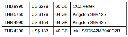

While it is true that the Kingston is not the top-of-the-performance-chart SSD, it does offer great value for its price. Where I live (Thailand), and when I bought the drive, these were the only options available:
When I bought the drive, I thought that the Intel would be too small, but in retrospect, I probably should have gone for it. My boot C: drive with Win7 Home Pro and all my apps, with everything loaded, and including a 3 GB hiberfil.sys and a .5 GB pagefile.sys, uses only 22.2GB. Oh, well.
