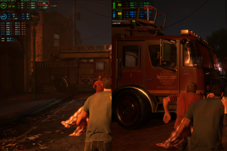

It seems like if the hardware was better utilized more power would be used. If it was some game specific optimization that reduced wasted effort by the hardware then perhaps power usage would remain the same.
I am just curious, not really expecting an answer.
That's a good question. While both usually contribute to performance gains, I believe it's more of the former in case of TLOU.

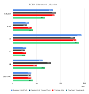

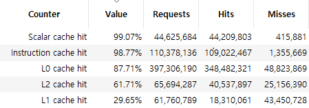

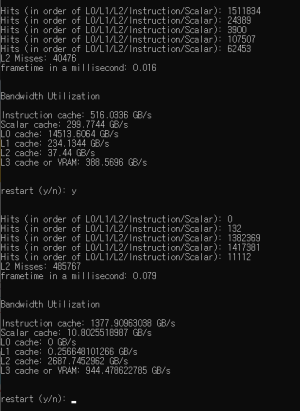

According to AMD, a cache request shown in its profiling tool is 64 Bytes or 128 Bytes. 128 Bytes for vector memory and 64 Bytes for Instruction/Scalar. So why not calculate data transferred in real world scenarios?

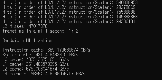

Wrote a simple program that calculates bandwidth with given values.

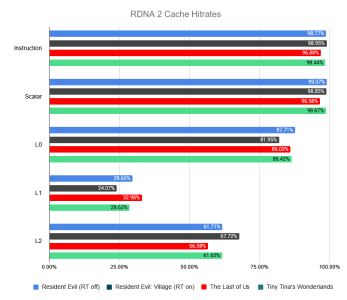

I tested these games with my 6900 XT at 4K simply because I have them installed on my PC.
Unfortunately AMD doesn't expose hitrate for L3, but this explains why AMD added L3 to RDNA 2. VRAM would be a serious bottleneck without L3.
RDNA 2's L1 cache is really bad. It spills too many requests. It's still acceptable in rasterization with other caches mitigating misses from L1. However it becomes problematic in ray tracing. Ray tracing hurts L0 quite a bit as shown in RE: V, and L1 can't mitigate the misses. L2 and (presumably L3) do all the work instead. They're just too slow for ray tracing. This also happens in almost every title with ray tracing support.
Although everyone is belittling RDNA 3, I wonder how RDNA 3's increased register files, L0, and L1 behave during entire frames. Chips and Cheese covered a bit, but only during specific workloads.
Forgot to mention that the graphs are average bandwidth required per frame. A single frame consists of thousands of workloads, and their characteristics are all seem to be different. While some workloads mostly rely on L0, there's certainly a number of workloads where L0 and L1 can't do anything. If not for L3, my 6900 XT with 512GB/s bandwidth would be choked in those memory-intensive workloads.

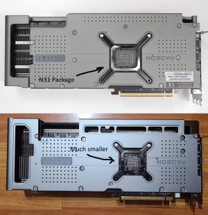

N31 on N32 package spotted in the wild. 84 CUs, 16GB:
top image is Nitro+ 7900XTX, bottom is 7900 GRE

Package certainly looks smaller than the one on the 7900 XTX / XT
Compared to N32 we have
5SE vs 3SE
80CU vs 60CU.
To overcome the raw hardware deficit you need 66% higher clocks to match in terms of ROPS or 33% higher clocks to match in terms of shader performance. Given the performance I don't think 160 ROPS is really required. Based on the spec boost clock of 2245 that would mean a 3Ghz N32 based part with 16GB of 18gbps ram should perform in a similar ballpark to this thing.
