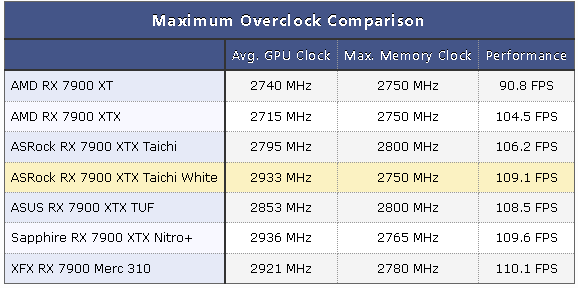

It really does not. Look at TPU who show the OC'd score of various AIB models and it takes a memory and core overclock to get the highest scores. Once you are hitting 2.9Ghz core clocks you need the ram to be around 2.8Ghz or you start seeing bottlenecks. If the core was hitting 3.5ghz in the 355W window then it would need faster ram and or more cache to give it enough bandwidth to feed it.
I am looking at It and there is no example of OC-ed GPU + stock memory, everything is OC-ed GPU+memory.
Or do you want to say that It's bottlenecked, because XFX has higher score than Asrock or Sapphire? Difference is <=1%.
I need a better proof that this.
