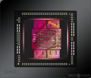

Can you clarify? N31 has two rows of three SE's. How exactly are the 3 SE's arranged in N32, all in line?
If you draw a line down between the right most 2 MCDS then what is left is the display engine stuff whcih I imagine stays the same, 3 SEs and the links for 4 MCDs + a little extra because N31 SEs have 16CUs rather than the 20 N32 is supposed to have per SE. It seems like the obvious way to layout N32 to me based on what angstronomics leaked and it would also fit with the 200mm^2 die size.
This is too oversimplified. You've got 48 СU's left this way on the left side, but 60 takes 25% more space and the N32 SE layout is 2 SA * 5 WGP, not 2x8.
Here I added 2 WGPs missing to each leftside SE and cut three rightmost SEs from the n31 die shot :
N31 is 8 WGPs per SE in 2 banks of 4.
N32 would change this to 10WGPs per SE in 2 banks of 5.
I also expect L2 cache to be halved for N32 because it has half the shader engines.
Here is a clearer image.
Fg-ai8-WQAEK_1H
If you can't figure out how N32 will be arranged from that without me actually sitting at my PC and doing the edit I can't really help you. You can very clearly see there is more than 6 WGPs worth of space available after you slice off the right hand side of the die to leave only 4 MCDs
Edit. Just seen your edit. N32 won't have the same L2 as N31. It has half the SEs so L2 is probably half as well and the command front end can be shrunk as well.
It's WGP area 37.5% less and it has 4mb of L2, and btw please keep that preachy tone away, 'cause I didn't ask for help and just shared my thoughts.
Fg-ai8-WQAEK_1H
N32 has 4MB L2.
