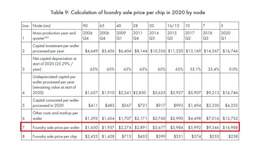

Yield for 5nm are similar to those of 7nm according to TSMC and that means defect per cm^2.
Thus, going up in size cost is superlinear because same level of defects means killing more wafer area. And a bigger die uses more wafer edge area because you try to accomodate a square shape in a circular wafer. 6N should cost less than 7N because less EUV steps needed. So, all in all, it should be more 100/110 vs 85 for silicon only. OFC package costs more.
Yeah, using this online calculator for simplicity
and 17000 and 9350 for the 5nm and 7nm wafer price resp.,
which gave me $97 for N21 and $84 for N32 ( I assumed 6nm the same price as 7nm)
Still curious though, what extra the new interconnect and packaging adds to the cost.
Reactions: Tlh97 and Rigg
Timorous
Oct 27, 2008
1,976
3,861
Where does 9350 come from for 7nm? I have seen 17k ballparked for 5n before but 7N was always around the 12k mark when Ian spoke with industry contacts and 6N was a bit cheaper since it goes through fewer process steps.
This means in the very best case laid out above N21 is 15% more expensive than N32 and I think with more realistic N7 and N6 wafer prices that gap widens further.
https%3A%2F%2Fsubstack-post-media.s3.amazonaws.com%2Fpublic%2Fimages%2F412ecea4-c5d8-412e-9c44-3658b3494650_1460x396.png
This is what Locuza came up with for N7 and N5 onwards.
