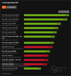

Laptop with the 7600S review. It's about 13% slower in the raster games they tested than the 4060 they compared it to, with both having the GPU power set to 80 W. I'd say it's not a disaster but not inspiring either.
TESKATLIPOKA
May 1, 2020
2,696
3,260
So the full N33 will provide raster performance comparable to Ad107, but much worse RT performance.
Compared to 6800S(Full N23) the performance is also pathetic, barely any improvement.
Not seeing any reason to choose It over Ada. If It was built using 5(4)nm then at least perf/W would improve significantly, but It is using only the cheap 6nm process.
N32 could have pretty good raster performance, but RT will be another flop. I don't think a laptop with It will be that cheap either.

In many results it seems taking 6800S over 7600S (both at 80W TDP) may actually be slightly preferable. RDNA3 is such an insignificant gen so far.

Quite strange results going on there... I think they made some errors in testing here and there. I.e. the 6800S 80W faster than a 6800M 120W in Cyberpunk? Yeah, sure. Also quite strange the fact that we see such a difference with the same memory amount on AMD vs NV cards. First time I see that, and we should have seen it plenty in the 3060 8Gb/3070 8gb vs the 6600 (which should be affected as well), as it is in more than one game. Quite unique.
In any case, yes, N33 is not a groundbreaking improvement over N23, even if this is not the full die.

Not to be nitpicky, but the 7600S (28 CU) is a replacement for 6700S (28 CU) not 6800S (32 CU).
It has a TDP range of 50-75W. The 90W is already running the AMD equivalent of Nvidia dynamic boost. The 6800S has max TDP of 100W.
AMD has not changed much in N33 die with respect to N23 die. It's still 6nm, so the 25% improvement from just architecture change is ok (zen 2 to zen 3 on same node had 19% improvement). We are still getting the performance of the highest previous gen tier for this 'S' variant of GPU.
Not saying this is a great card, but it's not that bad a card to disparage as well. It's just..... Meh :disappointed:
