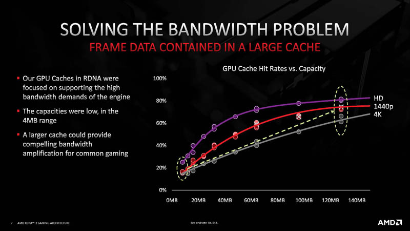

As long as they. improve the hit rate and make the cache sufficiently large, they don’t need a big, fast, expensive, power hungry bus.
Going off of this slide from HC33, doubling the size of the Infinity Cache should improve the hit rate for 4K gaming to ~80%. At 1080p and 1440p, it looks like increasing the size of the LLC won't help the hit rate all that much.
Reactions: lightmanek
Joe NYC
Jun 26, 2021
4,216
5,819
With > $1,000 graphics card (with 512 MB Infinity Cache), in 2022 onwards, the users will probably start to gravitate to 4k monitors.
At 1440, higher hit rate means less power consumption from memory, which then means GPU has more of the power budget.
That graph stops at 140MB though, while as you say for N31 rumored size is 512MB. It is likely that at that size the hit rate is near or even above 90% for 1440p or similar, with related bandwidth amplification effects. Well, AMD choice seems to be quite effective in the short term: GDDR6X is mostly a Nvidia exclusive (moreover it requires a different signalling, and it seems quite power hungry) so excluding EBM because of the costs we have that best memory available would have been GDDR6. Even by pushing it in the 18-20Gbps and with a 384bit bus, it would have been not enough, while with IC N31-32 will have an amplified bandwidth probably in the 2TB/s range (AMD declares more than 1TB/s of "delivered" bandwidth for N21 already). Moreover, the more the VRAM frequency increases, the more power consumption in the bus increases. Probably in the future EBM will become more viable and we will see some consumer design based on it. But for the moment it seems this IC solution is a fair compromise.
Yep, traditional GDDR memory isn't looking like it can scale efficiently when you transition to MCM. GPU manufacturers aren't going to slap on 2x384-bit memory interfaces for dual die MCM GPUs because it just eats too much into the power budget. It's rumored that Nvidia's Lovelace is going to slap on a large L2 cache (size unknown, but FWIW Nvidia A100 has 40 MB L2 cache); if so, it means they've probably also realized the same thing as AMD.
