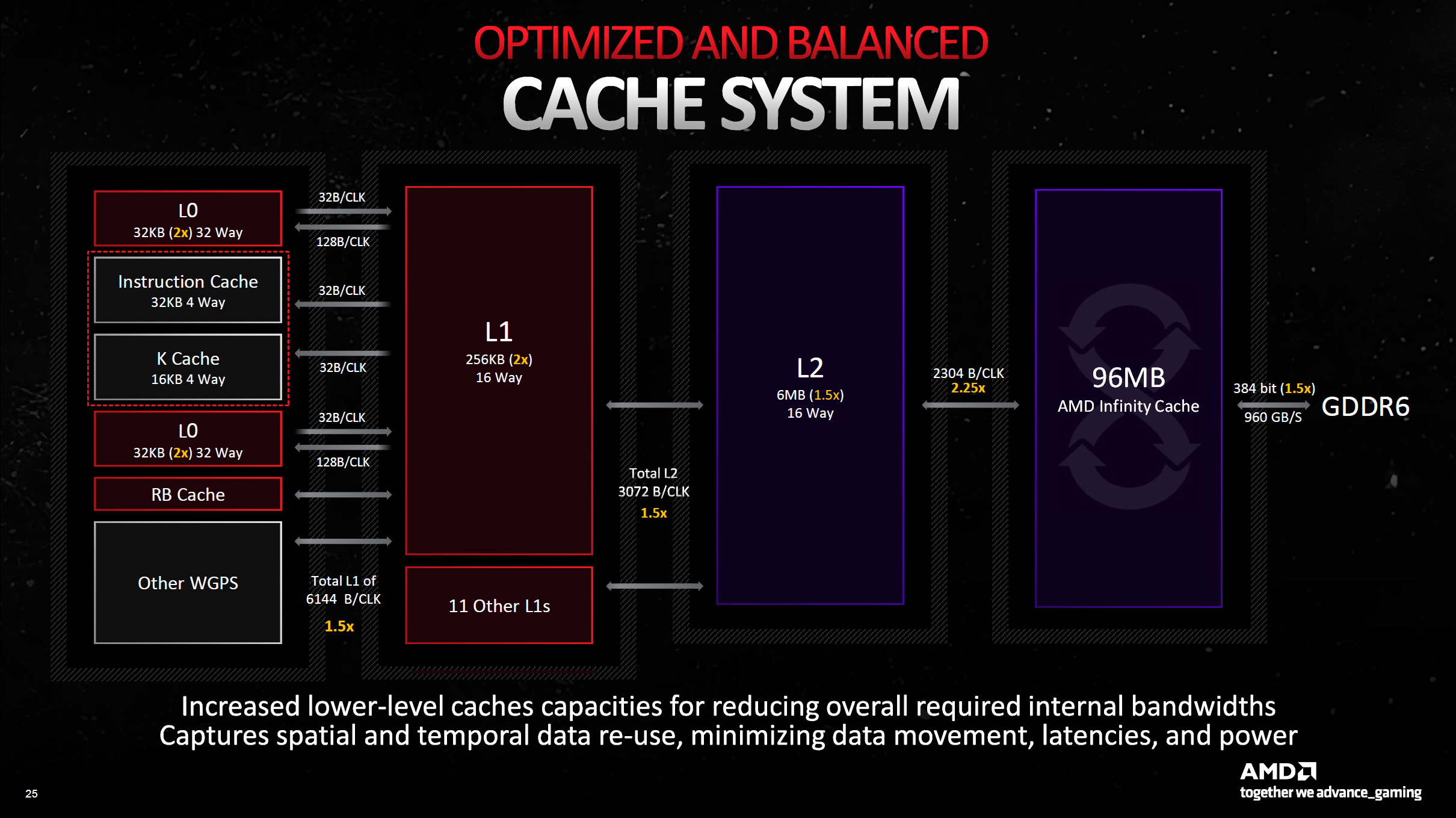

I made a BW table for Infinity cache 2.
Infinity cache 216 MB32 MB48 MB64 MB96 MB128 MB (doesn't exist)
B/CLK3847681152153623043072
Theoretical BW at 2.5GHz960 GB/s1920 GB/s2880 GB/s3840 GB/s5760 GB/s7680 GB/s
Hit rate at 1080p (BW)37 % (355 GB/s)55 % (1056 GB/s)65 % (1872 GB/s)72 % (2765 GB/s)78 % (4493 GB/s)80 % (6144 GB/s)
Hit Rate at 1440p (BW)23% (221 GB/s)38 % (730 GB/s)48 % (1382 GB/s)57 % (2189 GB/s)69 % (3974 GB/s)74 % (5683 GB/s)
Hit rate at 4K (BW)19 % (182 GB/s)27 % (518 GB/s)34 % (979 GB/s)42 % (1613 GB/s)53 % (3053 GB/s)62 % (4762 GB/s)
BTW 6MB L2 in RDNA3 at 2.5GHz has 7680 GB/s.
AMD did a good job with this.
P.S. I think Infinity cache 2 is working at ~1.9GHz based on this slide.
5300-960 = 4340 GB/s / 2304 B/clock => 1.88GHz
Similar speed as the first Infinity cache.
5300/2304 = 2.3GHz is the correct value.

So if your math is correct, 32 MB IC2 for Strix Point would have 1.65 TB/s bandwidth.
Very interesting.
Edit: ah heck. Only now I see that I missclicked, and wrote 1.65 instead of 1.75 TB/s.
Reactions: Stuka87
TESKATLIPOKA
May 1, 2020
2,696
3,260
I divided 96 MB and 5.3 TB/s by 3, which resulted in 32 MB IC and 1.75 TB/s.
IC on Strix Point should be executed the same way as it is on Navi 31 chips.
That's wrong, because It includes BW from GDDR6.
5300-960 = 4340 GB/s is BW for 96MB infinity cache.
I just don't know If this is the theoretical max or not.
I need to find endnote RX-818
edit: I found It.
It looks like It's just max BW of Infinity cache without GDDR6.
So what you wrote is correct for 32MB, but effective BW will be lower because It depends on actual hitrate.
