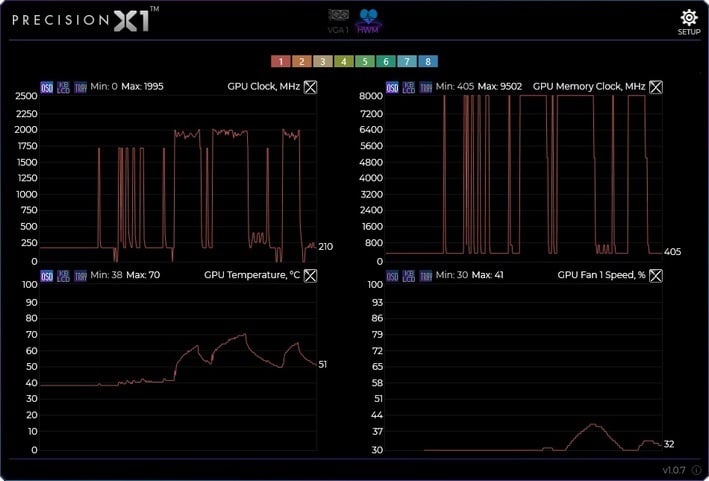

If this review of the 3080 is legit. AMD shouldn't have much of a problem equaling the 3080 with big navi. The power consumption of the 3080 is painful to look at. Remember, most 2080ti's sold were RMA'd within a month or two because of overheating issues. The 3080 uses 60-70w more than the 2080ti.
Most 2080 Ti's were RMA'ed for space invaders, not overheating. But one of the reasons for the fancy (and rather expensive) new cooler is because of the very high power consumption.

This is why I have an issue using the consoles to compare and try to evaluate RDNA2 in desktop.
(A screenshot / not mine, but seen and is real from a principal engineer at Sony that has been deleted)
