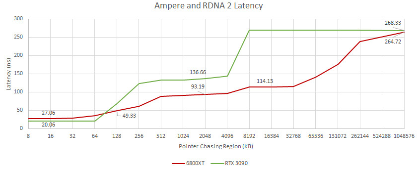

Here is a link to latency comparison between RDNA2 and Ampere
Latency comparison TPU
