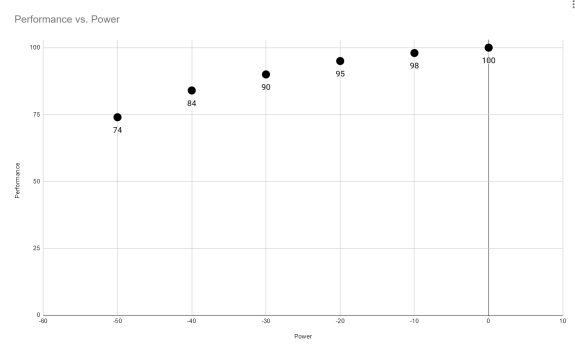

Has anyone done some serious testing with Navi 21 underclocks to give us some kind of idea about what to expect? Just the fact that they can clock so high suggests the
potential for massive power savings.
uzzi38
Oct 16, 2019
2,747
6,657
6800 non-XT tested here, MorePowerTool used to reduce power limits only. No undervolts etc applied - only the stock boost algorithm is being used here.
Unfortunately this isn't mine so I can't do any testing, I'm hoping to grab a 6800XT at some point. When I do grab one, I'll make sure I do this kind of testing with it.
TESKATLIPOKA
May 1, 2020
2,696
3,260
Is that power for whole board or just GPU?
