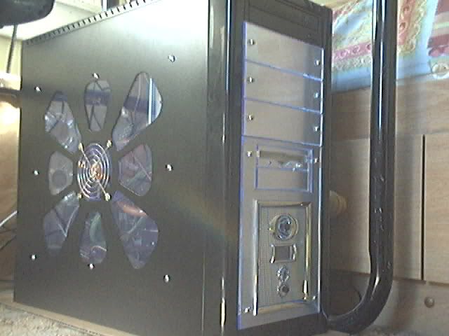

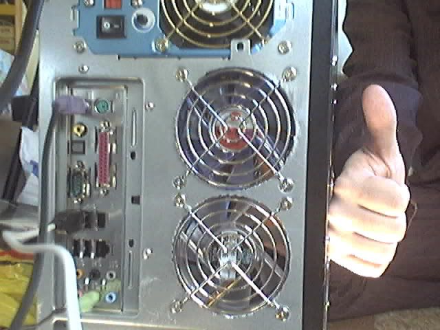

Also, I modified my own Enermax case like this...
http://i19.photobucket.com/albums/b182/forumposter32/backday.jpg
There already screw holes for the fans there and tiny holes for the fans but I cut out two large holes where the tiny holes were and added a second fan. When I'm gaming, if I put the fans on max, the motherboard temperature can go down by 7'C or 8'C.
That's amazing. BTW, there is a silver version still available I believe on newegg. Just look at mine, it has a knob to control fan speeds...
http://i19.photobucket.com/albums/b182/forumposter32/casefrontday.jpg
