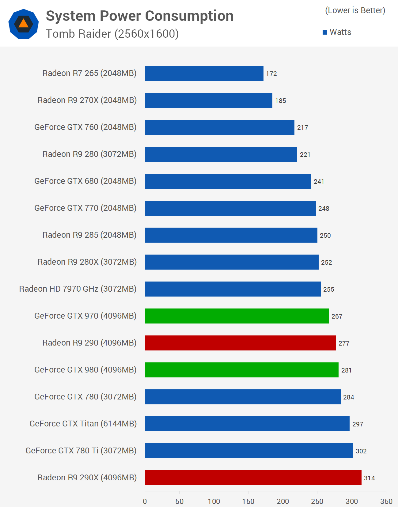

A slightly underclocked 290 draws about as much as a 980. They pushed these cards too high at release.
As I understand it, NV doesn't follow the same TDP rules as AMD. I realized this when I was looking into cards for a SFF computer.
GTX970 rated TDP is 145w. R290 doesn't have a rated TDP, but various sites have been guessing 250-300w.
In this chart, we can see that a 980 (165w) draws around the same power as a 770 (a 230w card) and ~60w less than a 290x (300w).

NV's TDP hasn't been a reliable indicator of the power usage of NV GPUs. Sometimes it's reasonable, other times it's way off. After-market 970 peaks at 190W+. 145W power usage for a 970 is just wishful thinking unless talking about averages. Average power load has its own limitations because some games can be CPU limited or a section of the game can become CPU limited at which point GPU load drops well below 99%. At that point it's natural the card will not approach its maximum power consumption limit since it's not being utilized to its full ability.

Completely overblown. The aftermarket models don't run hot at all. The Tri-X runs incredibly cool. In terms of total power consumption, a 290x in real usage uses 40-60w more than a 980. It's really not much.
