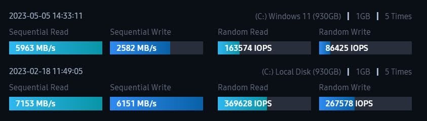

Numbers to show how bad write has decayed
Any way to see if cache is skipped other than guessing?
You may have a formatting issue or a setting in your bios might be wrong. I would start with resetting your bios to factory default settings. Reboot it a couple of times. Power it down completely. Hold the power button down for 20 seconds. Let it sit for a minute and reboot.
That's getting back to the basics. Report back and see if your performance improves.

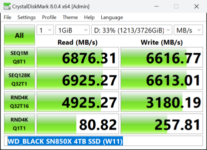

I ended up removing the drive and putting it aside and switch to two WD Black_SN850X (2TB/4TB respectively). I love the WD SSD Dashboard, allows easy firmware updates, temp monitoring, and enabling Game mode for a bit more performance

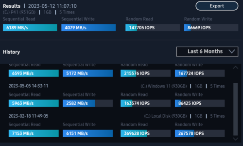

Sending back for replacement. We'll see
Moved OS to older drive to boot. Most recent speed was after wipe before return. Still just 2/3 of write speed back in Feb @30% full.

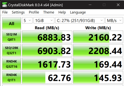

Strange, I just ran Crystaldiskmark on my P41, and I also noticed low write speeds.

QUESTION:
I'm noticing about half the Crystal benchmarks showing 3-4k RND4k Q32T16 and other half much lower like mine.
What's up with that?

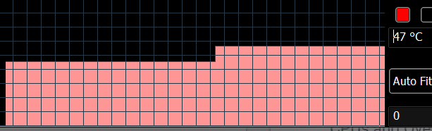

50c max temp. Using heatsink w/ MSI B760 Tomahawk
anothe run just now. 38c baseline. 47c during write ops
