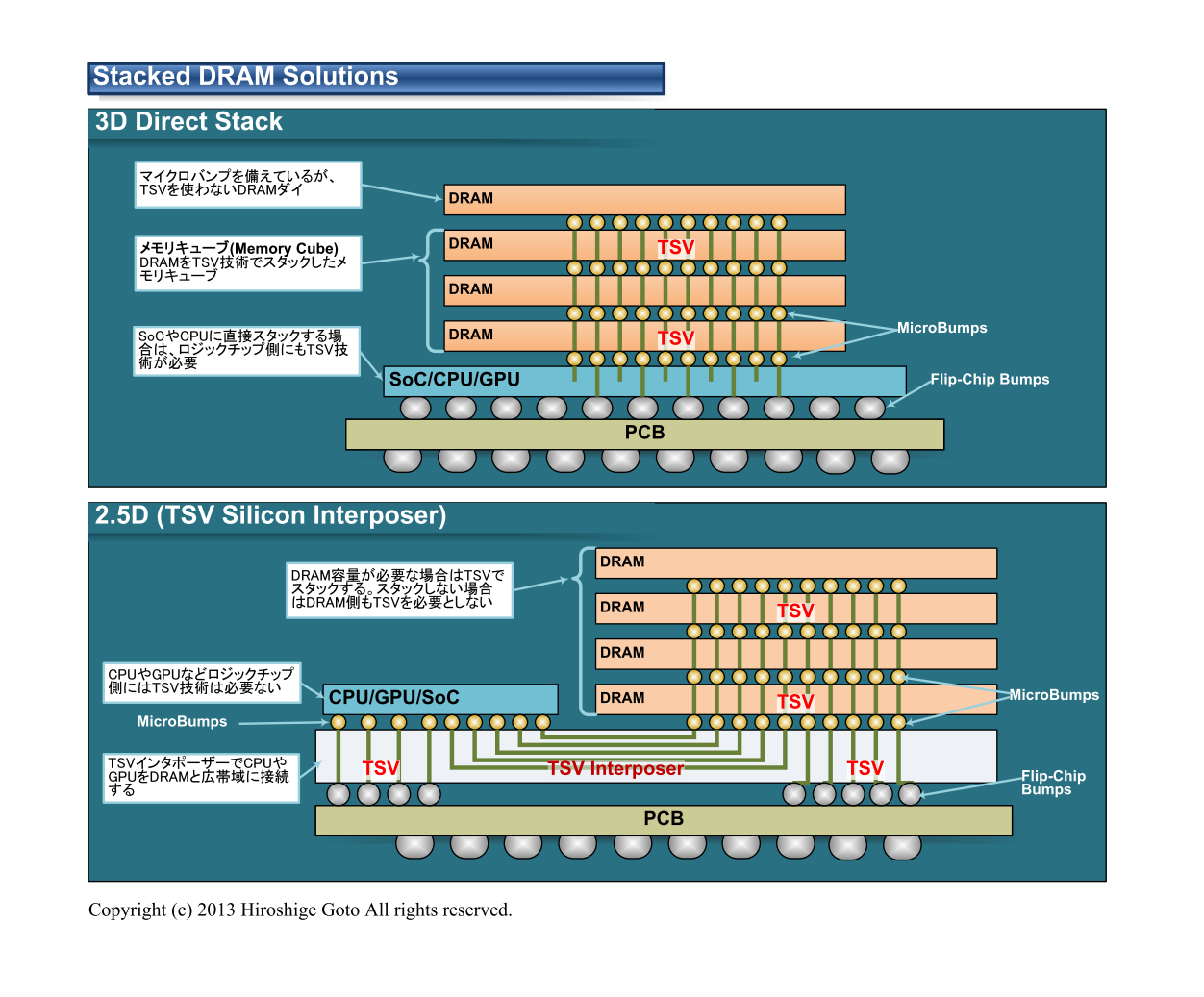

From what I have seen, interposer designs look like EMIB designs:
With the power pins separated from the data pins. I don't see any issue designing a chip that works with both Silicon Interposer, and EMIB:

Intel has made a big to-do about their tiny EMIB bridges being easier to fab that large silicon interposers. All the graphics I've seen displaying a hypothetical EMIB configuration, show little strips of green to represent physical die interconnects. It appeared that all signals to be transmitted from one die to another in the EMIB configuration would have to cross one or more bridges to reach the intended destination. The rest should be obvious from there.
Btw, EMIB and 2.5D designs are different and actually incompatible: 2.5D uses uBump only, C4 are on the bottom of Si interposer, EMIB is uBumps for EMIB + usual C4 for the rest of the die.

Look at the Silicon Interposer picture I included in the previous post. It is exactly the same way that EMIB is laid out.
Regardless of which solution you are using, you want the data connections closest to the outside near where the meet the other die, and power plane away from the other dies. Because regardless of which solution you use you want to simplify routing and minimize path length. This does not change between EMIB/SI, and both use the same bumbs/microbumps for connections, for the same reasonse.
These are functionally equivalent from the chip perspective.
The difference is that Intel solution is much less expensive, because it using smaller pieces of silicon, only where needed to run connections, while Silicon Interposer, is using one massive piece of silicon to cover the whole area.
Even if you need to be more picky in pin layout to minimize the EMIB silicon slivers.
There is NOTHING stopping an EMIB design from being used on Silicon Interposer as is.
EMIB is just Silicon interposer with excess silicon eliminated. They are compatible solutions.
And in this case, the Intel EMIB part exists, it could be used on Silicon Interposer with ZERO need for change.
Well, yeah. The bridges are embedded into substrate.
So?
Both EMIB and Silicon Interposer use a mix of microbumps and standard bumps.
Chips intended for Si interposers do not use C4 bumps.
C4 is on the interposer.
C4 is on the bottom of the interposer. The chip surface for high density connections uses microbumps just like the EMIB. Also note the high density connections are near the edge, using microbumps just like EMIB.
EMIB is essentially a cost optimization of Silicon Interposer. They are functionally equivalent from a chip perspective.
There is NO reason whatsover that a chip designed for EMIB won't work on SI. SI will just cost more.
This is going places.
Chip designed for Si has no C4 bumps.
Chip designed for EMIB/SLIM/SLIT/whatever else non-TSV interconnect has C4 bumps.
That's the main difference. EMIB design has uBumps only on the edge of the die intended for EMIB linking.
I see your point now. It isn't so much the high density connections, it's the low density ones, though it seems like this could be be mitigated, since these are often power connection and will be using multiple high density microbumps to eventually map to the bigger, low density ones.

I thought you said that EMIB requires C4 on the chip? Saying you can use the same chip for EMIB and SI is what I have been arguing all along, and you have been arguing against.
Only part of designed for EMIB-designed chip will have ubumps (the one that will latch to the buried bridge itself). The rest will be C4.
