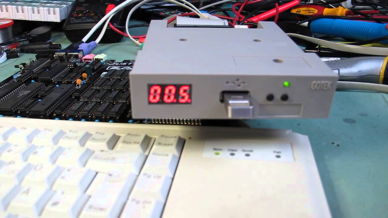

For convenience I also like to use a virtual (hardware) floppy drive. You can use these things directly with an old PC motherboard, musical instrument, sequencer, etc. They emulate a physical floppy drive. You write the floppy images to a flash drive with your main contemporary PC, and then you plug it in the floppy emulator. It looks like this:
Ah, a hardware floppy emulator. Interesting.
