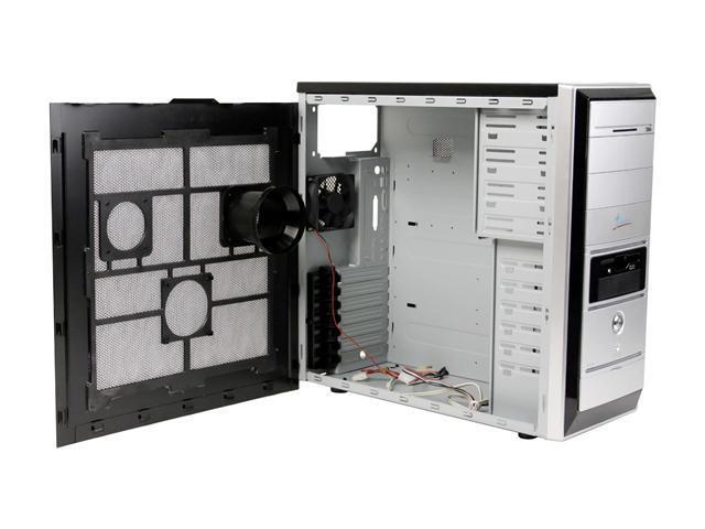

Hello everybody. I've been following these forums for quite a while and finally decided to join. For my system I'm planning on building soon, I've been considering this case, the Codegen 6209, recently featured in the Anand budget case review. I like it cuz of the toolless PCI slots and that side air duct. However, will sucking in air directly for outside the case actually do anything? Or is it completely superfluous? Thanks in advance for any help.

Don't bother with a pre-ducted case. Buy a case and install an air duct directly over your CPU HS fan intake with something like this.
It will direct fresh, cool air exactly where it's needed the most... into your CPU HS. :laugh:
Thanks. As for not getting the pre-ducted case, I'm not a big fan of taking a saw to my computer case side. If you have any other alternatives I'd love to hear em.
Take a look at the Antec 3000B case at newegg. This case is black, has some tooless features, and comes with a decent side air duct. This case is pretty quiet as well, plus it is relatively inexpensive.

As far as ducts, I haven't heard whether they help or hurt. Theoretically, they'd do both: they'd render an intake fan useless by obstructing air flow, but they'd provide a direct route for cool air for cooling the CPU. And that's for you, Spike -- you want the duct so that air comes in from the side, cools the processor, and after that you decide not to care about it. The purpose of the side duct is not to fix high case temperatures; it's to make those high case temperatures not affect the CPU.

Extra hole = extra noise exit. Personally, I don't like them. You just need to get a case with a 120mm fan in the front and rear and keep the airway as clear as possible of wiring and cabling between the two 120mm fans. AND, with the PSU drawing good airflow, heat will never stand a chance in a case like that........

Thanks for the Antec 3000 suggestion. I checked it out and it looks pretty nice, though a bit more expensive than I was planning
