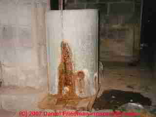

I wouldn't worry too much water heater leaks tend to be inside the casing and you will see wet spot or weeping around the base, and the most common leak is pinhole leak at the hot/cold nipples on the top of the water heater tank that take time to develop.
Slow side leak, and corrosion (possibly more than a year of leaking).
Top leak from corrosion, again the leak has been going on for many months possibly year/s.
Pipe and fitting leaking, also a slow leak from corrosion.
Below leaks are not related to water heater, but I throw them in just in case people want to know.
Leak due to saddle screw (electrical ground, etc...)
Split pipe from freezing.
