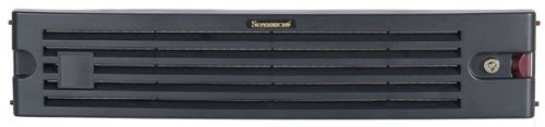

I have been TRYING to do research to get a front bezel for the server, but it has been a PITA. If anyone HAS one, and can enlighten me on the details of how exactly it mounts and whatnot, I would appreciate it. I sent emails to just about every seller on ebay with them, asking if they come with keys, not a SINGLE one knew, they all punted to Supermicro. Other pages I tried to find info (picture below), were TOTALLY fudged, would show completely different part numbers, so no what to know what is ACTUALLY being ordered. I even went as far as to send a detailed email to Supermicro directly explaining I am trying to get more info on part MCP-210-82601-0B to find out if it comes WITH keys, or what, how it mounts, etc. I got a single sentence response saying that "only a bezel itself and nothing else." I sent a response asking if there is a part number for the mounting bolt and keys for the lock, was told this has no mounting bolt, and that keys are generic. SOOoooo... can anyone tell me how the bezel attaches to the chassis (if additional parts are needed), and where I can find a set of keys for it?? I would be most appreciative.

Does your server look like this? What makes you think there's a front bezel for it, and what exactly would you need it for, if there is one?
** Edit **
Ok, I guess there is a bezel. Yes, it appears to have a lock. Looks like there are four tabs that fit into the protruding aluminum sides by the handles. My guess would be that the two on the left are stationary, while the two on the right are spring-loaded and released by sliding the red latch. The lock would block the latch from sliding.
The server looks a lot better without the bezel, IMO. I can't tell you how many bezels from rackmount computers we just left in the box when installing systems in data centers. They're little more than a pain in the ass when it comes to dealing with the hardware.
http://www.amazon.com/Supermicro-MCP-210-82601-0B-Front-Bezel-Chassis/dp/B001VWSM2Y
Yes, that is the chassis, it is a SC826TQ-R800LPB. And that is the bezel as well, model MCP-210-82601-0B according to Supermicro's website. This will be racked in my house in the basement, so I want the bezel on there so that I can have some filter media between it and the chassis (hopefully) to hopefully keep all of the fans and heat sinks free from dust and getting clogged. Open it up once a month or every few weeks to clean it out, and hopefully all will be well.
I didn't even NOTICE those little notches on the sides of the bezel. My thought was that it used the 2 larger holes which face forward which are directly below the handle loops (above the power button on the left side).
Thank you for the response!!
I don't think I would do this. That chassis is already fairly restrictive in terms of airflow, and adding a bezel makes it even more so. Then if you add a filter on top of that, you're looking at potential cooling issues.
