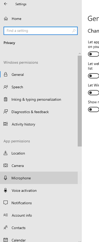

hi there. I'm currently encountering an unknown issue when trying to access the "App Permission" for my microphone in the Windows 10 Settings App.
If I try to click on Microphone:

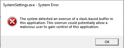

This error message appears, and the Setting App closes.

Have you tried to look up the hardware ID for the microphone/sound card device in Device Manager and try to locate a manufacturer's driver update for the machine? Or, even remove the driver and let Windows load a generic Microsoft driver? It sounds like an old driver is being used on the system that conflicts with Windows 10's protection for buffer under/overrun.

The error would seem to indicate that Win10 has determined your driver to be unsafe and has blocked it. There also could be a OS fault, or your system could be developing a hardware fault.
This is obviously an old system if it is the one listed in the first post. How old is your Win10 install? Was the microphone working and then just stopped working, or has it been an ongoing issue?

It may be blocked, or it may be a system error due to damaged or missing system files or bad drivers. If it is blocked due to an unsafe driver, you won't be able to unblock it without upgrading the driver. The audio chipset on your motherboard (which includes the mic port) is likely made by Realtek and thus you need upgraded Realtek drivers.

One thing that might fix this if it is a system issue is to run a basic repair install of Windows 10. You would need to download a version of Win10 that is the same or newer than the version on your computer (i.e. since you are running Win10 1903, you'd need install media for either Win10 1903 or use the media creation tool to create install media for the current Win10 1909), disable any AV/antimalware software, run 'setup.exe' from the new install media, and use it to "upgrade" Win10 to repair the installation and replace any missing system files while retaining your personal files. As always, make sure you do a backup of your important files before you try this - if you do it right, it shouldn't make anything any worse, but you can never tell so don't take chances with important data.
Here is a step by step guide on how to do a repair install in Windows 10 using either an ISO, a USB drive, or directly from the media creation tool:
